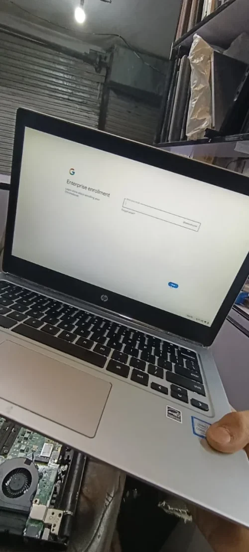

hp chromebook 13 g1
prodID W0T0IUT ABA
SN 5CD75ICPWC
MBOARD DA0Y0KMBAE0 REV E
CORE M 5 6TH GEN PROCESSOR
ISSUE ENTERPRISE ENROLLMENT ID POPS UP AS SOON LAPTOP IS ON BOTH EC AND MAIN BIN IS PROVIDED CAN YOU FIX IT OR REMOVE THIS OR BYPASS THIS ENROLLMENT OF GMAIL

hp chromebook 13 g1
prodID W0T0IUT ABA
SN 5CD75ICPWC
try this
must powerwash after writing this bios
patch.rar
WITH THIS PATCH YOU PROVIDED LAPTOP IS NOT TURNING ON I TEMPORARY REFLASHED OLD FILES UNTIL YOU GIVE ME ANOTHER PATCH
You have to wait for it must connect battery and then plug in the charger and wait for it to go on 15v from 5v then it is going to on
